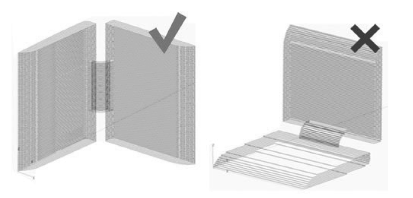

Living Hinge Design for 3D Printing
There are a lot of great options for prototyping hinges with 3D printing to test different thicknesses, placements and shapes. The resulting part won’t be as strong as an injection molded part, but should withstand enough flexes to properly test the component.
Best Material Option
When selecting the best 3D printing materials for living hinges, you should look for plastics with good elongation and flexibility. Nylon is a great option, for example.
Another great option is to prototype your part as a multi-material piece with a combination of VeroWhite and Rubber-like. Here’s a resource to help you prepare files for printing in two materials, giving you the functionality of a living hinge without sacrificing strength and resistance in the body if that’s crucial to your part’s performance.
Design Tips
When creating hinges in 3D parts, build orientation is very important. For the hinge to have maximum strength, the horizontal build plane should be perpendicular to the hinge direction.
Best results occur when the hinge thickness as at least twice the resolution of your print. Given that Nylon has a resolution of 0.254mm we recommend starting with 0.5mm as a minimum thickness.
Following these instructions should ensure your print gets at least 100 flexes in its testing cycle.
